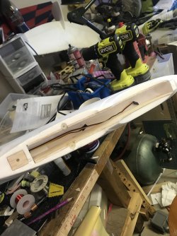

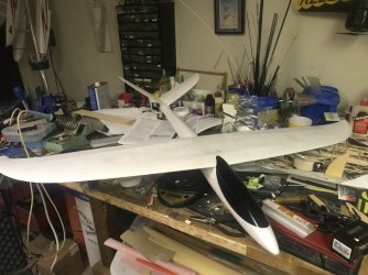

Well I’ve been working on my sail speedy for a few weeks now. I put some used HS 65s in the tail. I don’t generally like gluing servos in so I made some mounts to screw the servos in but epoxy got on them anyway so they’re glued in now. Next up is to find some servos for the ailerons.
I like the kit and the foam isn’t bad. In fact I like it more than epo. I sanded the flashing off and I used some light weight spackle to fill in the injection marks. It has a good surface and with a little sanding it came up very smooth.
my plan is to fly it as a sloper first then add a motor and folding prop later but I’ll see.
Anyway more later.

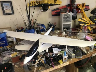

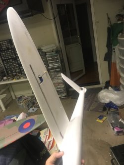

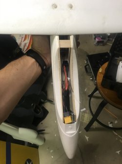

Here are a few more pics of the servos installed and the spar installed.
I found some 9 gram servos I bought from Aloft. I ran them for a few minutes on my servo tester they seem ok. I will run them again before gluing them in.

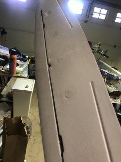

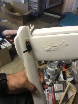

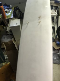

That’s where I filled in an injection mark from the manufacturing. I filled in one on each tail and four on the wings.
You’re right the new light weight spackle isn’t as good as the old stuff. But I find if I sand the large bumps off in one direction then wait a bit to make sure the spackle is hard I can get a nice finish with regular sanding and it won’t ball up.

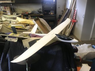

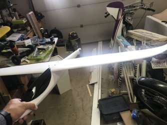

Well my sail speedy is ready for some test glides at my local park tomorrow. I also plan on adding some trim just not sure if I’ll do paint or cut vinyl.
I’m using 2 cell 1300 lipo and a bec I had to add about 2oz to the nose to make the CG look ok but I’m still only 14oz rtf. After some trim glides I’m hoping to go to Glider Point or Kite Hill this weekend and really fly her.
It’s been an enjoyable build and I don’t normally like foam. Too bad about the shipping rates. I would think aAeronaut could cut the wings at the factory with a hot wire for not much added cost. You have to glue the spar in any way glue the half’s together at the same time. Anyway more later.
