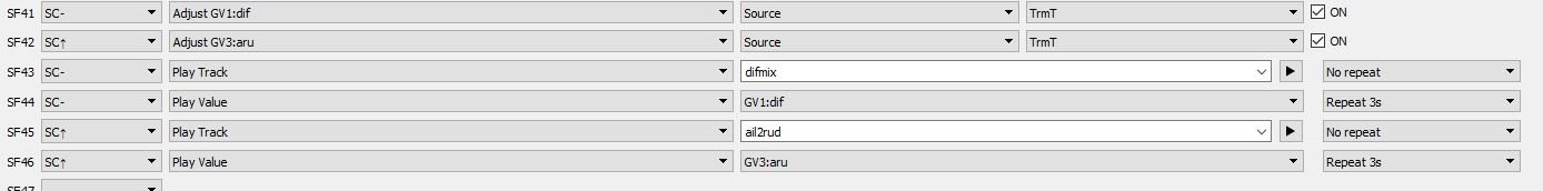

A replacement for OTX Special Function 'Adjust Global Variable' activate with a switch position and Throttle Trim as Source?
Bert

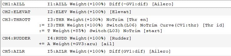

Within OpenTX, it is fairly easy to setup a variable that is adjusted with for example a trim switch. A switch then selects that variable that then can be used in a mix.
Attached you see two Global Variables GV1 and GV3. As an example, GV1 has the ability to create aileron differential (CH1 and CH5) and can be adjusted in flight while selected with switch position SC- and adjusted with the throttle trim. I find this very practical as am using this to adjust in flight flap 2 elevator compensation for takeoff and landing, flaperons for takeoff and landing, tailerons, aileron to rudder compensation and differential - all with just 3 switches.
In Ethos, I figured this should be doable as well however so far, no solution in sight without the use of Logical switches such as a Sticky/ Edge. To me, the Adjust SF / var is as important as the Override.

@Wayne, yes you can open options for most of the Mix Source or Value inputs such as weight and select for example a trim tab or analog switch however I loved it that I could use just the Throttle Trim for everything just by flipping a switch. I tried Function Modes, free and var mixes to no avail as I am unable to assign 1 trim to represent different values. But think about flying a jet at 50-60 miles/hr and be able to fine tune all the surfaces /mixes with just the throttle trim - I miss it in Ethos.
