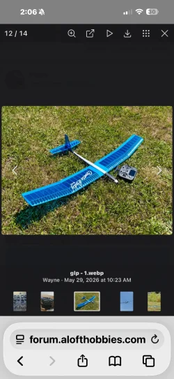

We mixed the sapphire blue and the transparent blue depending on what we were covering.
This is the pic I was referring to. Is that transparent on top and sapphire blue on the bottom? Anyway its a nice look.

Looking through the thread, did the trailing edge change between the prototype and and Alpha build 1 stage? The scallops looked nice under the transparent covering.
Yes, we switched to a normal trailing edge to combat the curling when the film was shrunk. The AG airfoil is very thin at the trailing edge, so more of an issue with this.
There is the fine line of keeping the build complexity in check while maintaining good cosmetics and performance. In this situation performance won out over cosmetics.
