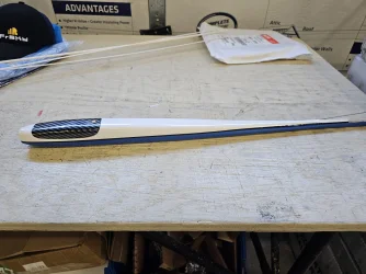

Alpha Build 1 looking good!
Fantastic! That flight video is great, especially the part where it looks like you guys drive commercial dump trucks to the flying field!
