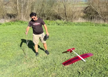

Maiden Flight Report​
We gave her a quick CG with a 800mah2S lipo under the canopy, she had a perfect CG. Check the controls, take a few photos and lets fly!
We like to do start with a glide test and if it is stable we add power and fly out. That is exactly what we did here. No issues!
She looks great with the sun lighting up here ribs.
I wasn't 100% sure if I had the wing angles right for the shoulder wing location, but instantly Jarron let us know she was handling great, and he started catching thermals. Within a couple of minutes he told me he was going to steal her so he could fly her this weekend. :)
Stall is a non-event, slow her down, and keep holding up elevator and she will stall and recover, stall and recover.. No bad breaks or sketchy behaviours. "We don't need no washout!"
Power level is just right, climbs to a comfortable altitude in 10 or so seconds, and if there is any thermal activity she is quick to point it out to you. Very nice.
We got a bunch of photos and video while we tested different flight objectives. Loops are not an issue, heck, she even rolls pretty decently for a rudder ship. Jarron did some inverted passes just because. you will see some in the video once it is processed.
We all took turns flying her, catching thermals, spiraling down, just having a great time. She is a sweet plane with some sporty credentials. We did a few landings that were as gentle as can be, and on the final landing Jaron tipped a little stree branch on final and ended up landing inverted. No damage! Woohoo!
