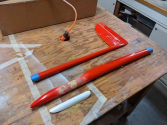

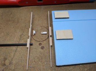

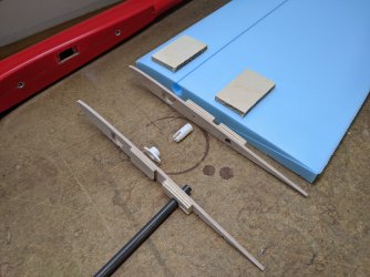

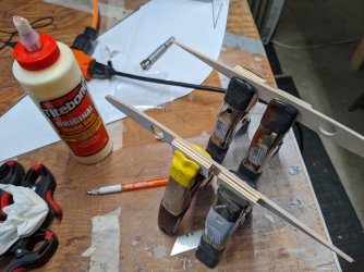

Got the gifted xplorer fuse in the mail and the wing cores i ordered.

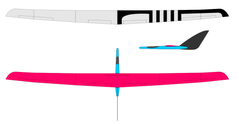

Playing around with some graphics. About 2" of forward sweep. Fuse doesnt perfect match the real thing, but the length and wing location are correct.

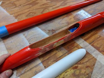

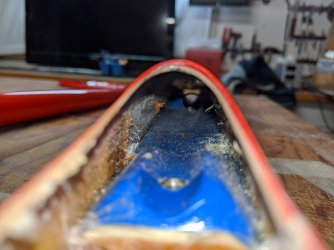

Some repairs are obvious but the forward section of the fuse is really strong and needs minimal cosmetic work.

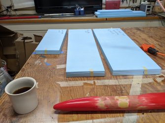

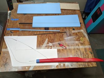

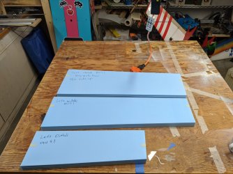

Heres the left wing. 2x 30" and 1x 20" section.

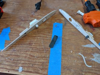

Nate, unless there is a size limit reason - or something like that, there is no point in having quite so many panels at different angles on your wing as per your drawing - though I suppose it looks quite unique!
I'd worry just a little about the span-wise flow on a flying wing of this type, as the leading edge angles will change its path quite a bit. You never know though - directing the isobars in this way could be beneficial!

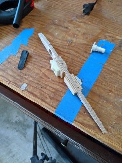

@Doc J This was the compromise we (daniel on rcgroups that cut it for me) came up with. The central 60" section we kept straight so that he could make a perfect tube cut to make my joiner install easier. IE i can glue in a 16mm carbon tube and know they match on each side. Its too late now so what it is, it is lol. I think it will fly fine. I have said it before, im not a picky flyer. All my planes fly different and they are all fun. So as long as it swooshes back and forth across the hill im good :D
Hey Nate : I'm sure it will swoosh along - in any case, high aspect ratio planken-wings are not that well known for their aerobatic qualities, and in any case with such a sterling advisory team how could it go wrong?
