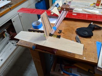

@Wayne @Doc J Yes its a copy of the Ridge rat. I started a thread over in flitetest on how i really loved the ridge rat and the ninja but have had you and others say its not the best flyer anymore so i decided to do a copy in fiberglass (GlassRat) and change the airfoil. @bracesport liked what i was doing and had just got into sloping so he started his version. We have kind of been building sideby side. He went with carbon over foam fuselage and trying the 3d print wing stuff i went purely fiberglass. I just put the tail feathers on mine
yeah @Konrad that's exactly the one i copied. Here's the balsa plans i based it off of:
I left the tail feathers dimensions and placement and distance between the trailing edge of the main wing and the tail feathers all the same. The only thing i really did was change the airfoil to mh32 and some minor adjustments to fuselage shape as i was sanding it.
