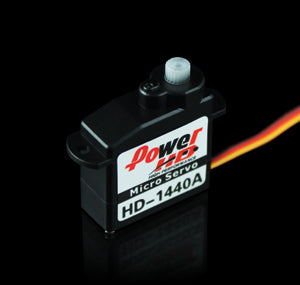

Another no nonsense brand in PowerHD. Anybody know how the amplifier performs on a single cell lipo?
Power HD 1440A - Micro Servo - 0.8 kg (11.11 oz-in), .09-sec - 4.4g
The Power HD 1440A Micro Servo is designed from the ground up with small models in mind.

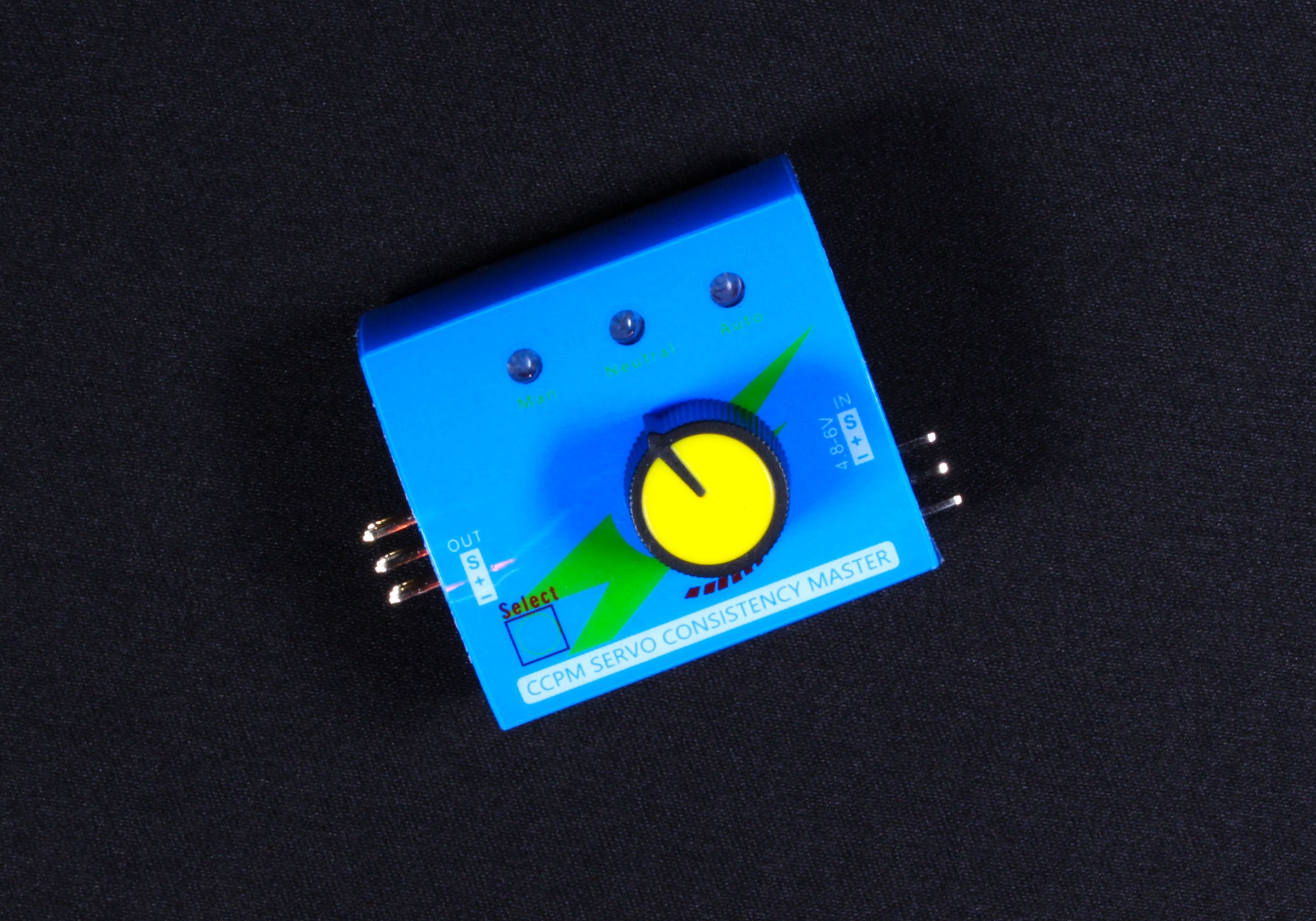

Since I'll be using servos off spec I really rely of burning in my servos before using then particularly if I'm glueing them into the airframe. I got into the habit of burning my servo when I learned that my Multiplex radio offered this function. I see that most servo testers now offer something close to this.
Most servos fail with in the first 3 minutes of use. How often do you hear the servo failed on the first flight with the result being the loss of a model on the maiden flight. Most electrical components will fail early if subjected to over heating during the assembly process. With the small size of the servo board it is easy to over heat things particularly when soldering on the leads. To weed out these premature failures I burn in my servos for 5 minute free running them on the bench. I also do a second burn in for a minute or so after the installation to make sure there are no issues with the hinges and linkages.
So another question is do you guys subject your servos through some kind of acceptance criteria before installing them into your airframe? And if so how does this criteria look?
